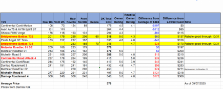

That $60 or $70 rebate shakes up the order a bunch.
My only question at this point is T32 or T33? I can get the T32 from Dennis Kirk for much cheaper than Revzilla. DK doesn't sell (yet) the T33.
Chris
Just throwing out some info.
Right now, Rocky Mountain is giving an instant $50 rebate on sets of Bridgestone tires. That brings their price down to $440 per set (of T33) which, while still outrageous, is the lowest price I've found. And then factor in the $60 rebates that Bridgestone has going on their tires this month.
