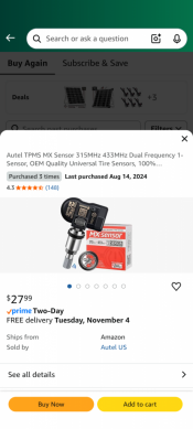

Anyone that's interested in autel tpms sensors that are pre- programmed and ready to install. PM me. Your original sensor ID, that's printed on a label attached to the sensor, is required.
