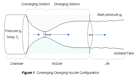

is the reducer based on converging/diverging engineering? we have learned about why, but how it works is what i'm interested to know steve.
we studied this in the navy and its cool.
what you've depicted is a venturii, which is what makes a carburetor work. That's not the same as the velocity cone. The cone is dumping into a larger pipe, and the idea is to prevent backpressure from the downstream side of the cone from being able to travel back up the header to the cylinders. Basically it keeps the air moving in one direction, toward the muffler.
