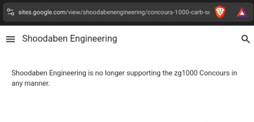

Hey, Steve. I'm glad you're here to help us think about this stuff. Though it's too bad you've stopped supporting the C10 in anyway shape or form:
Your older videos are great! A lot of sage knowledge. Hope you keep those videos/articles up for all the young whippersnappers that are buying up C10s as retro bikes. And I hope you continue supporting the C14 for the foreseeable future; that stuff really helps the community, and we all know you're about community. You wouldn't be trying to get us to "think, not parrot" if you weren't!
