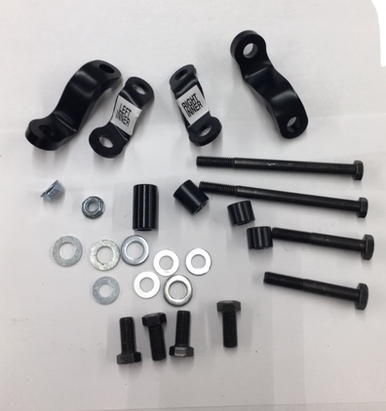

Murphs still sells the hardware kits for the tipover bars ( bars not available) . Might be good to have if trying to make some .
Yeah I Had considered it. I'm concerned that brackets aren't going to be strong enough to support the weight of the 5\8th solid bar I was planning to use. I'm planning on them being honest to God crash bars not just tip over bars (also a mounting points for side lights)(maybe hwy pegs too)
Honest to God crash bars ( I had them on a Honda 750) Most likely would have folded in on a crash bending or breaking the frame in the process. Tip over bars most definitely fold in on a crash but do not usually damage the frame. I tried it myself and they folded without damaging the frame. Anything jutting out is going to lever and put great force on wherever it attaches to the motorcycle frame. Sliders and pucks only stick out a couple of inches and protect the engine.

Ok good information, will watch out for the motor mount bolt. I was still planning on bolting it to the motor but was planning on instead of 14 gauge steel for brackets I was planning on using 11 gauge and have the brackets bend before the bar. Should be a bit springy before it bends. Plan on doing the rear pretty much the same design, just beefier.
If you make the crash bars too strong, your save the plastic and break the engine casing.
Suspect a welder could use the parts from Murphs and this to make a set.
Not sure about the gage strengths. (I'm not a welder)
On the ones I posted I doubt their as strong as the ones that used to be available.
ie; Might not be strong e'nuff to completely prevent any plastic damage.
But the chance of damaging an engine case (from being too strong) is bad.
