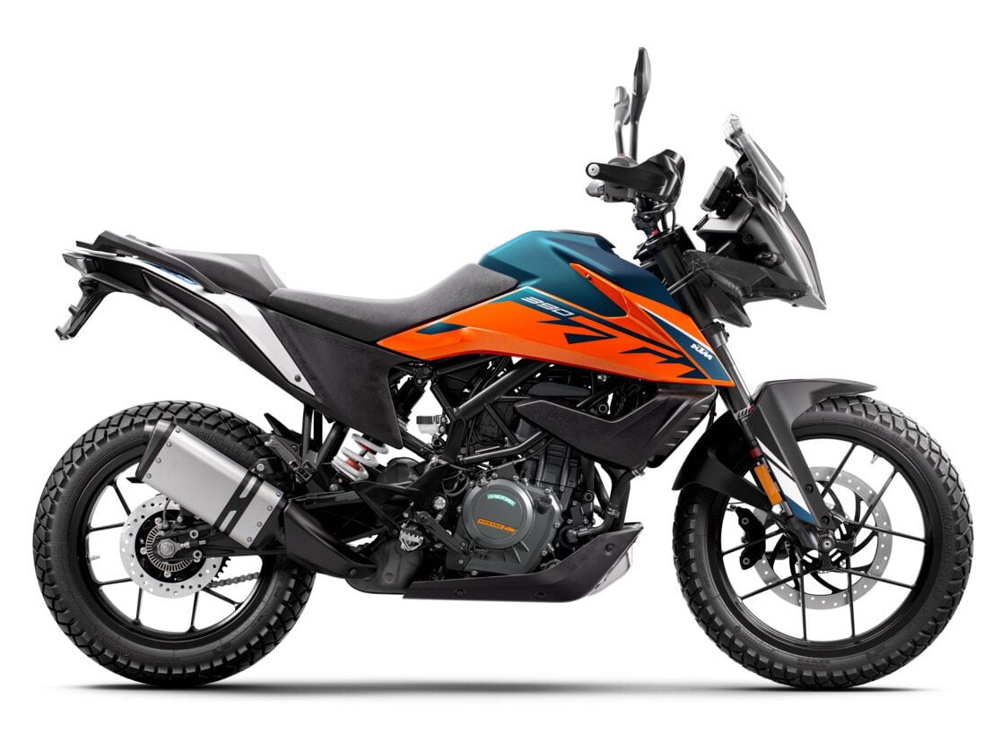

After getting passed by a 390 Duke at our sport touring school, I acquired a liking for that little motor, and every review was good so I bought a left over 2022 for $7,000 out-the-door tax tag title, I'm happy, salesman said it's a gift because they aren't making any money:unsure:

That’s awesome!
Shedding 250+ pounds plus nimbleness must be likened to a car driver saddling up on a performance go-kart!
I am sure you are still removing the protective film but do let us know how you like it. For sure looks like a fun corner rocket and the built-in technology (Color TFT, Drive By Wire, Bi-Directional Quickshifter, etc) must be a welcoming experience.
Did bags come with the machine or are they optional?
What’s them wind protection like?
