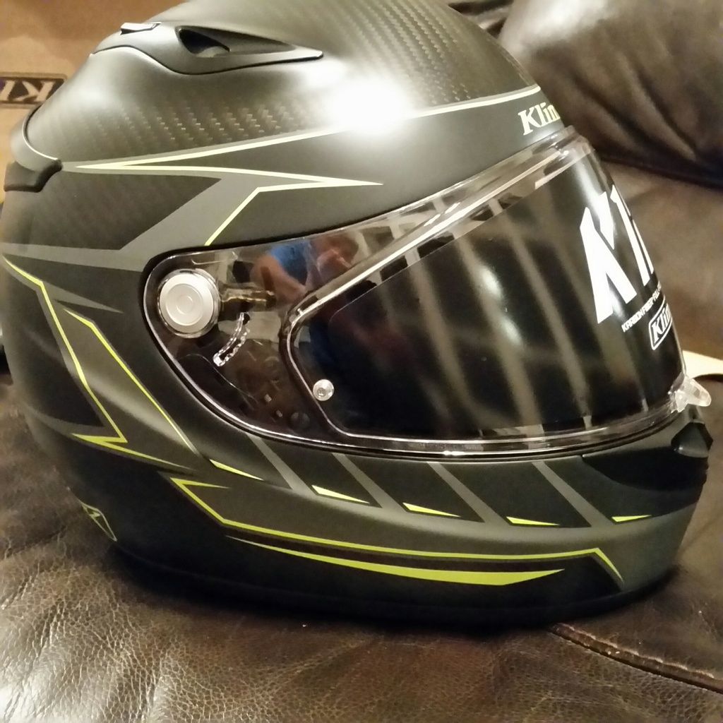

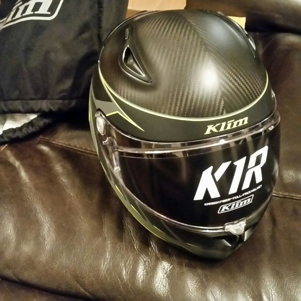

Well, I've been on the road the past week+ traveling a bit around Texas, but unfortunately it was NOT on the turbo bike but rather in the cage with mama and Pflash the wonderdog. We've been traveling visiting family, helping the mother in law move, eating too much food and visiting a bunch of awesome grandkids.    I only returned home a couple of hours ago, but found on my front porch a box from KLIM Snowmobile.  Inside was my new K1R helmet that my wife won as a prize at the National in Helen and was good enough to give to me.
So there in Helen, I got to try on the helmets and pick my colors and what-have-you.  While it's been hard to wait, tey said the helmet would be delivered in October.  But much to my surprise and joy it got here a little early.  Since I arrived home long after dark, I haven't had a chance to see the Transition shield turn dark yet, but I've tried it on and latched her down and made some motorcycle noises and this thing is sweet.  :motonoises:
While this helmet seems designed to accomodate a variety of head shapes, it has a noticeable bend towards a rounder head shape than mine I think, but iby going a little smaller than I typically do, the sizing and fit seem quite nice.  Firm fitting and non-rattling when shaking the head.  It's also not cranium crushing which is a trait I cannot tolerate that a lot of helmets seem to have when I undersize them or they just do not fit.  THis one seems to do a good job accommodating my fairly eliptical orb.  More on that when I've had a chance to actually ride with it for a while.  In the meantine, here are some pix.

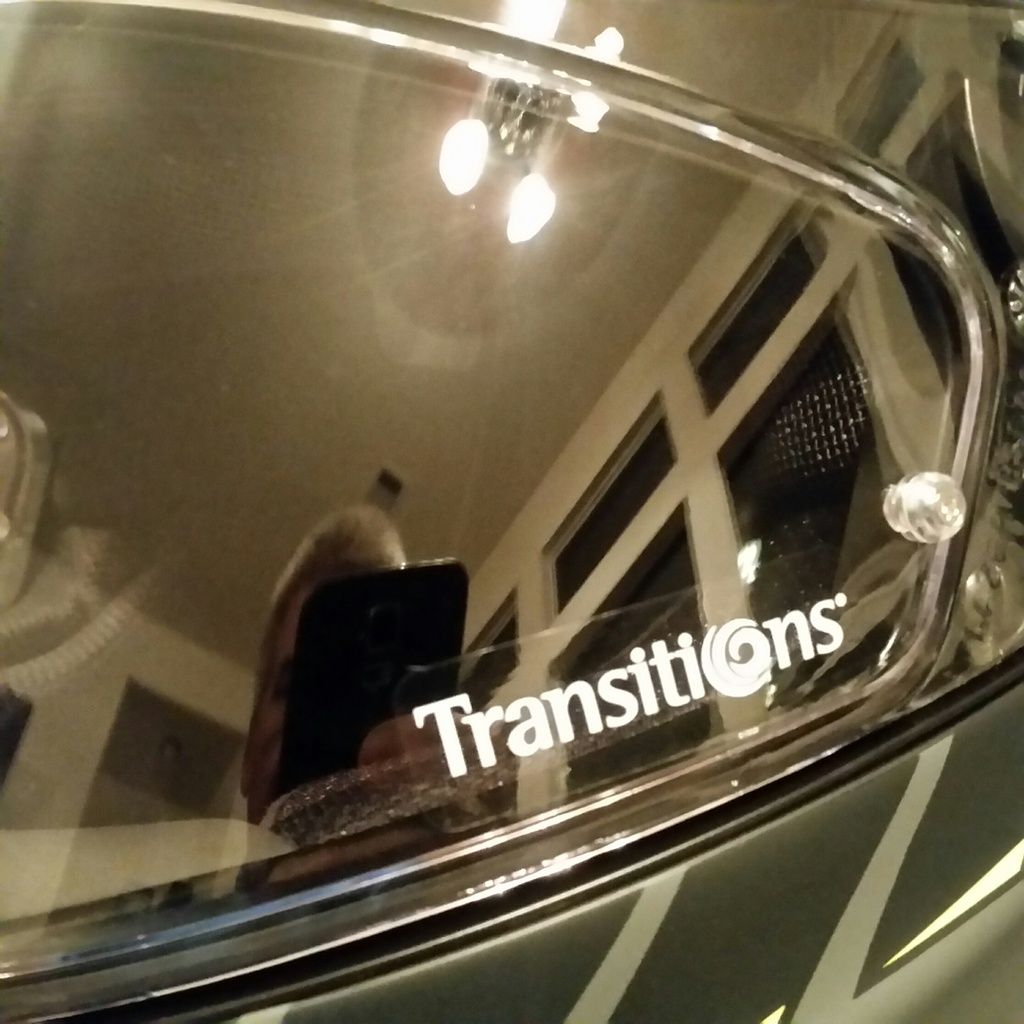

Hopefully a ride and a report tomorrow.  I did take the helmet outside to watch the shield change from clear to dark.  It was cloudy when I did it so it didn;t transition too dark, but quickly became very, very noticeably darker.  More as I learn it.

THis helmet is probably quieter than my HJC full face helmet, but it's not as quiet as I had hoped... but I'm getting ahead of myself I think.  Getting on the bike and putting on the helmet you are immediately and always struck by how crazy lightweight this thing is.  It is featherlight almost.  I have to speak now about fit.  As I said before the helmet is not an exact match to my head shape and so there is really little contact on my ears in there.  It is what KLIM calls a moderate oval (I suppose that means between round and oval since it seems round compared to my long front to back head skinny side to side noggin) but yet despite the reduced contact in some areas it feels really comfy and secure.
Once latched on and shield put down it seems very quiet, but reaching up to "snap" the vents open yields a fairly LOUD click through the carbon shell.  It transmits contact noise rather loudly. If you are someone always clanking helmets with a partner, this might be really annoying.  Fortunately, I generally ride alone and so it's a non issue to me.  Just thought it needed to be mentioned.  ROlling out of the driveway and rolling into the throttle the helmet feels really solid, but did I mention how light it is?  When you turn your head to look somewhere at a stop sign, it's almost like not wearing a helmet. VIsibility is far better than my other helmets and the superlight shell fits so solidly and stays with your head so easily that there is no bobble or hint of helmet rocking/slipping... again, it's almost like not wearing a lid.
Now I typically ride with safety sunglasses and the shield up.  I like the air in my face, the dark lenses, and the eye protection factor.  What I don't like is the bug that splatters all over my face or misses the helmet and the glasses and nails me in the nose or cheek or worse, gets wedged into the helmet alongside my head. What I also don;t like is the way my sunglasses make the windshield appear weird and even the rode sometimes.  With the transition shield I got some of what I like and missed some other stuff I like.  Lets start with the transition part.
WHen I first walked out into the sunlight, the shield was pale and the sun quite bright. But it only took moments before I realized a reduction in brightness... but it didn't seem very dark.  I wear contacts and have very photosensitive eyes and so I was afraid the shield would not give me the low light I really wanted and was tempted to put on my sunglasses underneath.  Well, I wound up taking them and stuffing them in a pocket just in case.  But the case never came.  I rode in comfortable light with outstanding vision (for a blind bat like me) that I have not had with any other lens system including the popup type shades in some other helmets.  Now I'll admit, it was noon time so I was NOT facing into a strong sun.  ANd even then a couple of times I raised the shield momentarily to see if it was transitioning, but it was and while not as dark as my glasses, was perfectly comfortable to me.  And because I actually had the shield down, my eyes had less irritation and drying than is typical for me.  I think that could equate to more time comfortable in the saddle for me.  Kudos KLIM.
