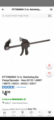

I smoke mine 😉

We're probably using the same cheap HF clamps.
You're right. I'm using my clamp to keep the bead from coming up over the rim when I'm putting the tire on. If I feel like I am having to fight it, I just look to where the bead is and push it down.
