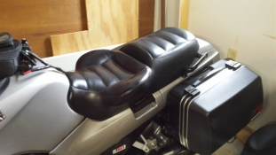

It's a Medium sheared black from Alaska Leather (see link below), sitting on my late-model Corbin seat. The later Corbins have a rider pocket area about 2" longer than the stock 94-up seat and old Corbins, and the medium sheepskin fits the larger seat area perfectly. You could trim it down if your seat is one of the smaller ones. It is a very nice sheepskin, and has a nice elastic strap around the front, and buckle strap under the bottom.
I'm still figuring out what I like best. The sheepskin is more comfortable than the Corbin alone, but the Corbin is hard as a rock. In that photo you can see a bit of foam peeking out, and I'm still experimenting with some different types to see what works best. I'm also working on modifying an older Corbin or stock seat with some custom foam.
Thanks Seth.
I will get one ordered this evening.

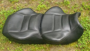

I have a Russel leather, "Day Long" seat but I can not use it due to my 29 inch inseam. Those of us who are vertically challenged can not deal with the extra height and shape of the saddle. See attached pic. And I lowered my bike for a better fit. I never ride 2up anyway as my wife worked an ER for about 12 years and will not come near a bike.
I put a stock seat on and I have been able to stay on the bike for 4 hours at a time in relative comfort. Adding a sheepskin pad should make it even better. Would like to do the 1000 mile baby Iron Butt at the end of June if I have enough confidence in my bike by then?
