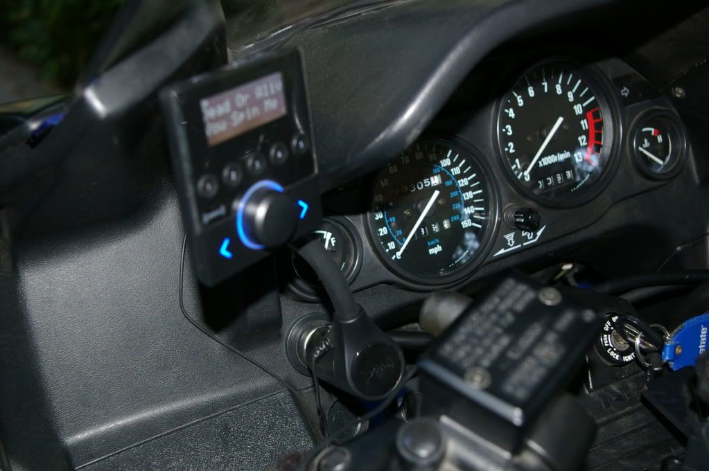

I recently installed the SIRIUSXM "Snap!" unit on my C10.  I first installed a Powerlet-brand socket (from Murphs) under the fuel gauge like I've seen so many other members here do, then simply plugged this unit in there, with the antenna wired on the center of the dash behind the windshield.
The flexible arm lets me angle it just perfect, and the big knob and buttons work really well, even with gloves.  Most of the weight of this unit is at the bottom (the socket plug) so the thing does not budge.  The audio output and antenna input are at the bottom, so no wires up at the head.
The left bar *does* come in contact with it on upon going full-stop to the right, but there is enough give in the flexible arm that it's not a problem.  I just completed a 2000 mile trip with this setup, and it worked perfectly.  If you Google hard enough, you can find the Snap! unit for free, with $10 shipping and a free month of service.
