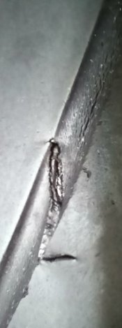

I friend had a puncture on his rear tire recently. It's from a 2019(?) Gold Wing (latest generation), and the tire still has some life in it. I will add that he's not rich and if the tire is not repairable, his bike will be in the garage for a while.
Please, if you're in the "never repair/patch/plug a MC tire!" camp, refrain from answering as it will likely be unhelpful - thank you in advance.
The hole appears to be a small cut, rather than a nail hole. Crazy looking damage. Appears to have been caused by something having an "L" shape, with the long part having a sharp point at the top.
The two photos show the damage, with a 3/8 adapter shown for scale. He is considering removing the tire and patching it. Since the steel cord is visible, and I'm pretty sure a few steel strands were cut, my thought is that it is not repairable.
Currently, the tire takes several hours ()not days) to drop pressure and he has working TPMS system.
Thoughts? Is it repairable for local, low speed (he always stays below the speed limit) rides?
thanks! Jorge

I've patched and plugged tires before, and ran them for extended periods of time. I've also run a tire with a nail in it for a while....
The Goldwing is a HEAVY bike, and that's damage at the lower part of the tire, with cords showing. In addition, it already looks like his tire is a bit old, or has at least seen some age, given the rubber cracking in the second picture.
Can he run it and probably be fine if he does an internal patch above that area? Sure. You can give it a try. I just worry about the weight of the bike. If it goes, its gonna be bad....
Now, if that's in the sidewall? No go. Park the bike. But I'd do the soapy water test first, see how much its leaking, then pull the tire and put a flat patch behind it. I'd say that'll last another 1k miles at least.
This is all opinion, and based off of anecdotal, personal experience. Do NOT take what I said as some sort of rule to go by. Just my opinion. 😎

I think I zoomed in too far... It's about 1/3 the way from center to the side; here's the wider view.
You can hear and feel the air escaping, but I had to use liquid leak detector (I have it for chasing air leans in our motorhome's air system) to find it.
The reason I'm pretty sure several cords are cut is that I was able to place a think Allen key along the length and the sound would change over about a 3/16" length; making me think that air was escaping along that a cut that was that long.
I know any repair shop won't touch it (I've always heard that shops won't repair an MC tire).

I suggest that repairing the damage like that will be expensive in terms of risk to such a critical component. My suggestion would be to search Craigslist and Marketplace as I see people selling tires at very low prices. The Gold Wing is a popular bike and there is a good chance someone will have a matching tire available. The tire may be older than desired (>6 years), but is much less risky than the repair proposed. That is my 2 cents worth.
I'd go with a new tire...100% eliminates trouble from repairing the old tire, and theres not a lot of things in life you can 100% on.
If moneys an issue *shrug* Ive patched HOLEs, as in punctures, ( using a patch on the inside). Seeing cords is bit of concerning. Its not hemorrhaging air so thats a plus.
I see that there is a place not that far away that has used tires at very low prices. This could get your friend by for the remainder of the riding season and allow time to “gear up” for a new set. I am hopeful the information is useful.
Heavy bike+cord/belt showing sounds like a blowout is coming. I’ve ridden on several plugged tires for a long time. It doesn’t always work out.

Yeah, jeez, if he had access to a tire changer and it was just a round nail hole,hmmmm, man, that's a hole I don't like on a Wing, 50cc scooter, sure, Wing. And, I've plugged a new tire and rode to CO and back from OH, but this is a jagged laceration.
Interesting place Robert. About 160 miles from here. The Wing rear wheel is not too hard to remove, so if they had his size, potentially he could ride they ( it'll hold air for longer than the ride), and have them mount a tie.

Jorge the best thing to do would be to replace it, but if ya gotta do it,,, it's usable if he's careful.
Question; Is he going to have the tire removed from the rim or will you/he be doing it?
Reason I ask is; if he's having it done, no shop will touch that repair.
If you/he are doing it put a very good patch on the inside and fill the cut (from the outside) with super glue gel or some type of rubber cement..
ie; I wouldn't use the rope type that pushes thru the hole as they will stress the cords more.
If you/he repair it, ride it slow and EZ and keep an eye on it.

There is an offer for tires with abouts 50% life left, but older Wing (180/60 vs 200/55 specified). He's researching if it'll work.
I don't think I would be comfortable patching because of the cut steel cords. That would put a lot of flexing at that spot, putting a lot of stress on the patch.
My view:
Option A: use the offered tire (if it fits)
Option B: fill the tire to max allowed pressure and ride it to the used tire place
Option 3: Save $$ for a new tire.
