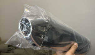

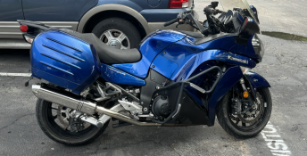

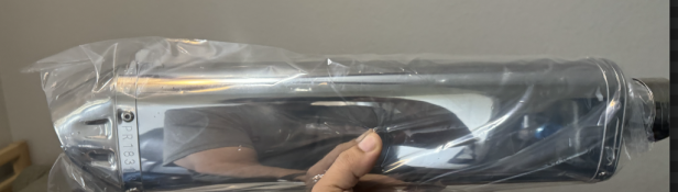

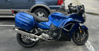

Got the potato off and installed the Delkevic 17 Tri Oval exhaust. Very easy install. Took her for a quick spin and she sounds nice. Subtle lower tones, but overall pretty quiet as first thoughts. I installed with the baffle out. Next is the Windshield install.
