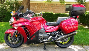

Me and texas.devops went to Mexico yesterday and did some Roll-on Test's.
After Steve came up with the idea for a restrictor in a Delk or Black Widow system, I decided to do this on a dual muffler system to see if the reducer idea would do anything. I wasn't sure, and Steve wondered too.
(Quick answer. It does, and can be used to tune your torque curve). See below.
,,With no restrictor's, the bikes were basically even with neither pulling away at low/mid rpm's. (bike seemed a little abrupt at lower throttle openings)
,,With 2 restrictor's, his bike pulled away slightly at low/mid rpm's. (bike seemed to hesitate at lower throttle openings)
,,With 1 restrictor, my bike now pull's away slightly at low/mid rpm's. (bike feels really smooth at lower throttle openings)
NOTE: Texas and I have 2 bikes that are very close to one another in performance. At high RPM's their even.
ie; (The restrictors changed high RPM power very little. (If at all)
Because of the Roll on comparison, and because we have such closely matched bikes, we are able to "see" what is happening.
If you don't have another (closely powered) bike to compare with, it all comes down to your Butt Dyno and Butt Dyno's lie!
That said: A Butt Dyno does tell you differences.....
When I installed 2 restrictors, I could feel that something wasn't right. Removing 1 of the restrictor's, the feel was noticeably better.
NOTE: I'm NOT talking about WOT. I'm talking about partial throttle/low RPM torque.

The Torque Effects (after adding the restrictors on my 2 muffler/ZX-14 header system) was questionable as a 2 muffler system could respond differently than a 1 muffler system.
I've done comparison roll-on's with 0, 2, and 1 restrictor's.
ie; After each restrictor change a roll-on was done with the same bike/texas.devops to look for change.
The restrictors "definitely" made a difference and I think the 1 restrictor set up is best in my muffler system.
ie; I really liked the way the bike delivered power at the Tennessee event, and I may go back to that (1 restrictor) set up after the National.
But, I want to repeat (0 restrictor) Roll-on's to be sure.. <evil grin>

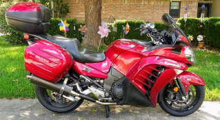

Ride report;
While at the National, I was able to do only one roll on test with Laker. (4 pulls)
The other folks that planned to meet/compare modifications didn't show up. (??)
NOTE: The main purpose of this test was to see why his bike hasn't pulled away from Red as it has a Full Area P System.
(See previous reports [66, 67, 74])
New Mods;
Since our last meet, RED was unchanged.
His bike had been gone thru with valve adjust/plugs/fuel pump.
Additionally, he installed a Yoshimura exhaust, (pulled his flies??), and built his own Flash.
We both thought his bike would pull away at higher RPM's (and maybe also at low/mid RPM's because of the Yoshimura exhaust)
Results of the test; There was only a slight change from previous tests.
At low RPM's (2000 to 2500 RPM / 3 runs) RED would jump ahead a length or so, and then the bikes stayed at that spacing until we shut it down. (approx. 7,000 RPM)
The only exception was when we did a higher RPM start. (perhaps 5000 RPM)
On that run, his bike pulled RED slightly and then the bikes stayed at that spacing until we shut it down. (approx. 10,000 RPM)
We were both puzzled by the results. His bike should be beating mine.... (???)
After discussing things, "he" feels that there was some improvement, and further refinement of his Flash will be the solution.
NOTE: I'm not posting this as a brag.
(We're trying to find a solution to the Delima and I think that eventually he'll find it).
But (being me) "I" told him that painting his bike RED is the refinement that needs to be done. <evil grin>
As both of us didn't see the runs the same, I'm hoping that he'll read this report and clarify things that I reported incorrectly in my report.

What's SRCA stand for! :sneaky:
Yer close but no Ceeegar.
SRCA stands for; "Superior" Red Connie Association
