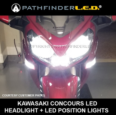

I’ve got the pathfinders up front. I got the switchbacks for the front signals on amazon. I converted the rear signals and tail/brake light to all red running lights. I added Whelen LIN 3 red lights on each side of the license plate to function as brake/turn lights.
This was before I converted the brake light to a running light.
The little lights between the headlights referred to as "city lights". I replaced the stock ones with LED versions from PATHFINDER that didn't seem to last very long and were expensive. Bought a package with 2 made by Sylvania Superbrite LED's for $21 at my local Auto Zone store. They are just as bright, less money and I can pick them up just anywhere. Keep in mind when you plug them in if they don't light up, remove and rotate 90 deg. LED's are polarized.
